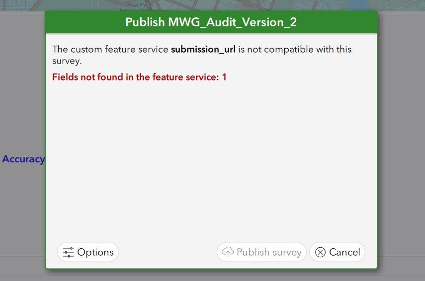

I tried the calculation step using a hidden question.
I got an error shown in the screenshot below.  This is beause the 'Defect' field does not existing in my Hosted Feature Layer (i.e. existing data).
I added a new string field to the Hosted Feature Layer called 'DefectNo1' for the purpose of accomodating the hidden question.
The Survey successfully published, but the defect_no_ was missing from the watermark (see screen cap 2).

If you do not want the new question/field added to your existing feature service, you need to set the bind::esri:fieldType for that hidden question to "null". See my screenshot and example xlsx file. When null is specified in that column, the feature layer does not get updated when you published, and when you submit records, so data is attepted to be submitted for that question/field. From your screenshot above, it appears you did not set the "null".
