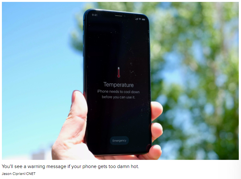

Summer is coming up fast and my organization is in an arid desert climate with temps often exceeding 100 degrees Fahrenheit. For our field workers, should their devices in the field experience a shutdown or malfunction due to heat, does the data in a survey123 form gets saved or retained somehow if it force shutdowns itself due to overheat safety features on mobile devices?
Eg. an autosave, inbox save, or warning text due to device condition?
If not, I would like to copy this over into the idea page for survey123 if it doesn't already exist.
image source: https://www.cnet.com/how-to/why-your-phone-gets-so-**bleep**-hot-and-how-to-keep-it-from-overheating...
