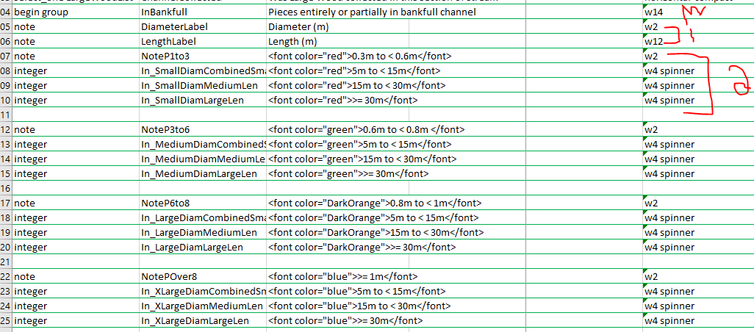

Sorry I cannot.  But all you do is start a group and give that group the total width you want.  Then each field you can tell it how much of that width to use.  Each time you hit the max width you get a new line.
Use the appearance column for this.
Here is the width at 14 then a 2 + 12 = first group, 2 + 4 +4 +4 is second group and so on.
Hope that makes sense

AngelNicoleAlvaro1
Hi, Doug. Can you please send the XLS form that you used for your example above? I'm still new in learning the grids in Survey123. Thank you.
DougBrowning
MVP Esteemed Contributor
AngelNicoleAlvaro1
Thanks, Doug! Understood this completely.
