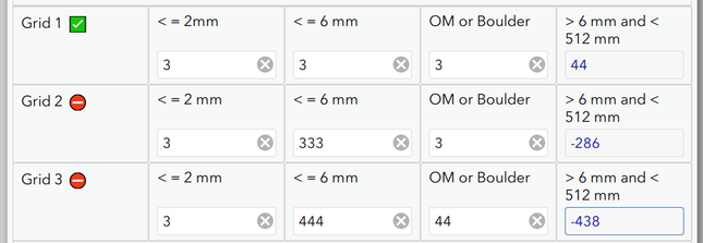

I would also consider using emojis which save a lot of space.  Code is similar. See my post on how to do that here.  https://community.esri.com/t5/arcgis-survey123-documents/how-to-simulate-instant-data-checking-using...

Thank you! This is a great option to allow us to flag values that fall below our threshold. Worked beautifully!
