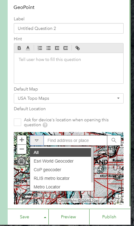

I'm trying to add a custom geolocator from our ArcGIS server. It is currently shared on AGOL through our Portal. It is not coming up as an option in the search bar for the geopoint widget. I've shared it with my organization, and publicly, but it still doesn't show up. The three locators listed in this screenshot under the ESRI World Geocoder no longer exist. Any idea why are they showing up as options?

With regard to the list of locators, the locators used by Survey123 are those that have been set as locators used by your organization (part of your ArcGIS Online organization settings).
