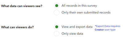

I have users in the group added to be able to View Survey results, with the ability to "View and Export Data".  Only they get the error "You do not have permission to perform this action. Required privilege: create content."
Checking the Sharing settings, they have the correct permissions in the survey to export, "View and export data".  Only that is not true, it appears they also have to be a Creator.
Unless I am missing something they are not creating anything in AGO/Portal just downloading the data.
  • Perhaps an asterisk should be added that Creator is required to download content locally.
  • Or remove the Creator requirement and anyone with permission to View and export data, could do so.
I found this useful chart, only we would rather not have to bump a user looking to export data from a survey to a Creator.  Are creator licenses are limited.

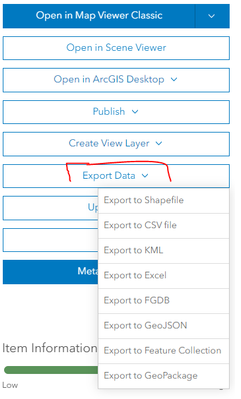

This happens to me a lot when using the Export button in AGOL on a layer.  The issue is the way AGOL does it.  When you export it creates an item, then you download that item.  That is why it has to be a creator.   I think I have seen this posted in AGOL board a few times but cant find it.
That means this is a AGOL issue not a 123 issue and I am not sure they can do anything about it.

Thank you for the thoughts.  As far as I can tell when you export from the Survey123 Website using the Export dropdown.  It does not create a layer/table on AGO/Portal.
I fully get what you mean if you're using the Export Data directly on a feature layer, however the Survey123 Website, seems to handle things a little differently.
Export changes to Exporting...
Next a file shows up locally in your machines default download folder.  (no need to specify a path/name, it just shows up)
While ideally, I would like anyone classified as a viewer to a survey to be able to View and Export data.  As the radial button implies, if that is not possible, adding a note that exporting requires Creator User type, would be super helpful.

This is what is misleading:
That should say Creators!
