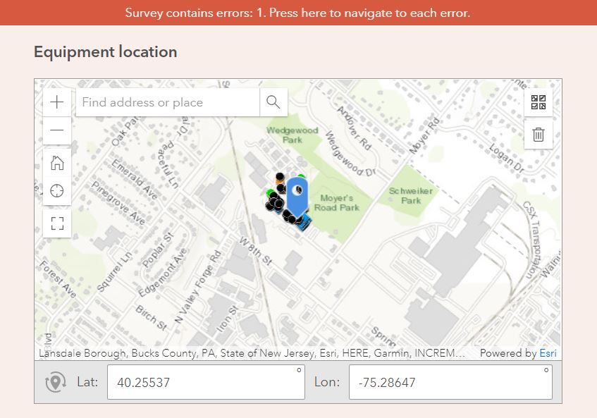

This is going to be a long post, and I apologize but I want to paint the full picture of my issue.
I'm having an issue with a survey I built from a feature service that has a related table. It's a FC of all of our vehicles and equipment, for inventory and maintenance purposes. There's a related table that would store all the maintenance done on that vehicle/equipment, for easy reference to those using the equipment.  It's a two part survey where half of it would add a completed maintenance record to the related table, and the other half would show that maintenance is needed on something. It uses pulldata and cascading selects to autopopulate the location of the vehicle/equipment on a map to fulfill the 2nd half of the surveys functionality. Ideally, I want to maintain both functionalities so that I don't have to update the csv of 2 different surveys every time we get a new vehicle/get rid of a vehicle/move a vehicle to a new department (which happens easily once a month). Also along with this, I want it to be available through web format, NOT using the Survey123 app, because with many users who I don't regularly see, I don't want the users to have to update the survey every time a vehicle change occurs.
However. I'm concerned that I'm trying to do too many things in one survey, or have some things in there that are unnecessary to accomplish my goals, and that's the cause of my error message. I have no issues publishing, but I cannot submit a survey. Everything appears to function as it should, but just does not work. There is no error code, it just says "Survey contains errors", and highlights the map question.
I tried to take the mapping part away, thinking maybe that was the issue, but still, no luck.
Not quite sure what's going on. Any ideas?

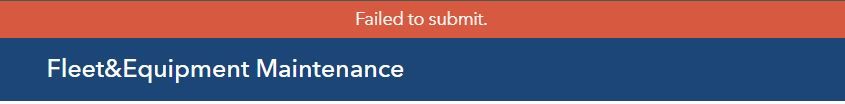

Hi all,
I followed the steps to create a survey from an existing feature service in S123 Connect and published the survey.
Unfortunately, the new survey will not send responses. I get an error that says "survey could not be sent due to the following error: (then it just shows the instance name) Do you want to edit this survey?"
It appears that the submission url and form ID are correct. I did add a few fields in AGOL and then in S123 Connect and republished with success.
Interestingly, when you try and edit and look at the geopoint question, the survey does not populate any of the maps that have been linked in S123 Connect.
Responses are currently backing up in the Outbox.
Any help is appreciated!
Cheers,
RyanE

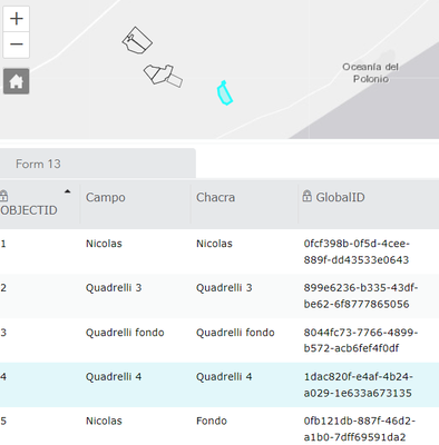

FedericoRiet_Sapriza
Hi @JamesTedrick @IsmaelChivite
I have created a S123 survey with a features services (layer polygon, geoshape).
I have several polygons with their respective names. I would like the field user to select a polygon from a name list (not from the map) and then the data collected will be associated with that polygon.
In the screenshot you can see my table and each named polygons. how to do you recall them in the form? pulldata?
Thanks for you help

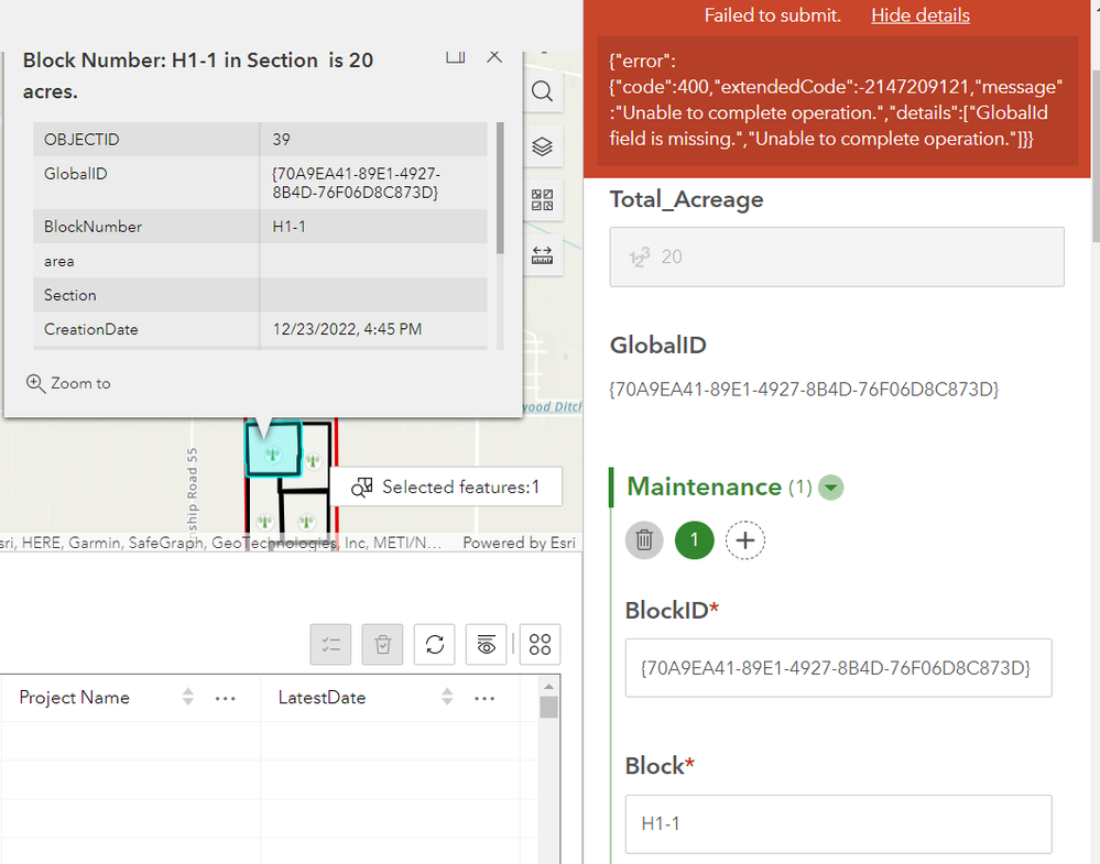

DavidTreering1
@IsmaelChivite
https://community.esri.com/t5/arcgis-survey123-blog/working-with-existing-feature-services-in-arcgis...
I'm not understanding how to retrieve the GlobalID from a feature and submit it as the foreign key in a related table record.
Here the related table's BlockID is a GUID in the Relationship class to Feature Class Block's GlobalID.  Table has it's own GlobalID.

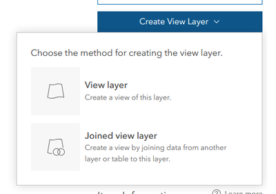

@MirjanaLovenjakYou need to make the View layer:
1. Log into your Portal
2. Go to the parent layer EDIT: In your case, it likely won't be a "hosted" layer. Just go to the parent Feature Layer.
3. Select "Create View Layer" and follow the instructions

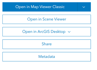

MirjanaLovenjak
Hi @abureaux ,
thank you for your response.
For some reason, I don’t have that option on my Feature Layer (see photo).
Is there an option I need to consider for my Feature Layer in the Enterprise database or during publishing?
abureaux
MVP Frequent Contributor
Oh, darn. That option may not be available for non-hosted feature layers.
The only other place you could potentially create a Layer View is from the Survey123 website (https://survey123.arcgis.com/surveys) on the "Share results" page:
If that isn't available, you may need to make the view in SQL and publish that to Portal.

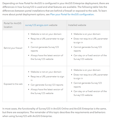

Hlynur
Hey @IsmaelChivite ,@MirjanaLovenjak@abureaux  & @HannesVogel. (as the last 3 of you were tackling the question about refenced services and not hosted ones)
From your problemshooting and solution suggestions here above I take it that it is possible to build Survey123 functionalities on referenced feature services (thus not hosted ones) on Enterprise?
If so did you use Survey123 or Survey123 Connect to accomplish this and which of these installation types did you go with?
Asking cause we have a strict behind a firewall setup for our whole Enterprise conglomerate that only allows referenced feature services. So before undertaking the task of setting up Survey123 then I would like to hear the experience from others what is the best way to go about that (or if it is even possible to achieve fully behind a firewall)?
With regards, Hlynur.
HannesVogel
I use Survey123 Connect from the Microsoft Store but you can download Connect also from the Survey123 Website. I also have a exposed to the web connection so I don't know what happens in your deployment. There is a feature service template for survey123 connect to test and adapt to your feature service.
