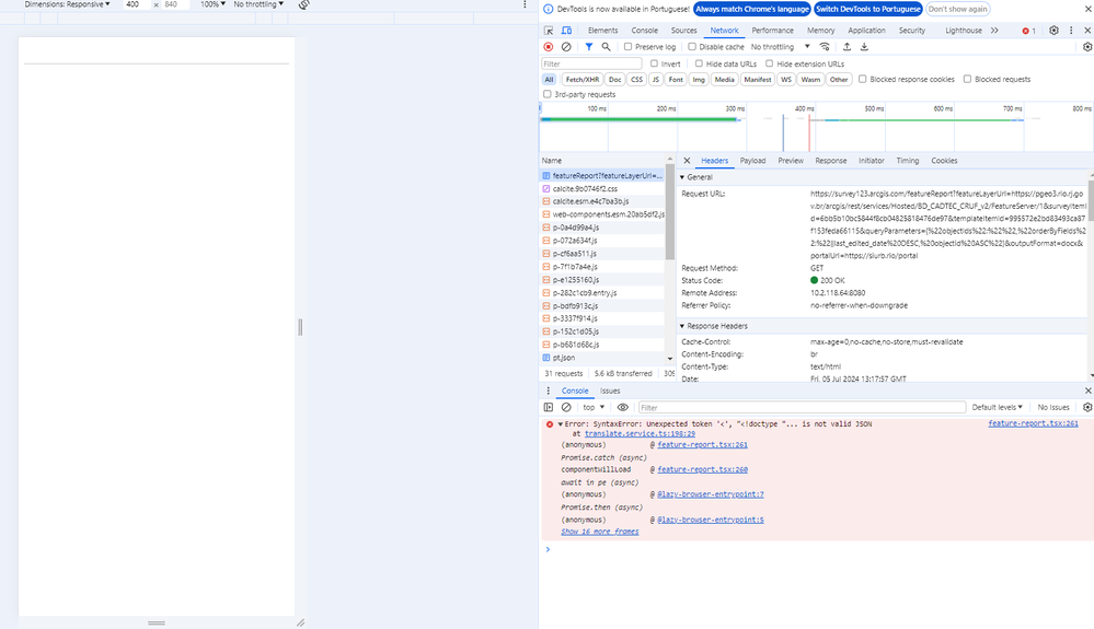

Has anyone had success with new reporting page? I tested it on Enterprise and AGOL, on some forms, and I always get a blank page with a dividing line at the top, but without any interface or information.
Is any additional configuration required?

If you still get errors, can you please open the network panel in the browser developer tools, refresh the page, and share a screenshot of any errors you observed?
SMH-Rio
Thanks for the answer, @ZhifangWang
I am using the link that Survey123 itself provides on the Data page. I believe that all mandatory parameters are being informed:
https://survey123.arcgis.com/featureReport?featureLayerUrl=https://pgeo3.rio.rj.gov.br/arcgis/rest/services/Hosted/BD_CADTEC_CRUF_v2/FeatureServer/1&surveyItemId=6bb5b10bc5844f8cb04825818476de97&templateItemId=995572e2bd83493ca87f153feda66115&queryParameters={"objectIds":"564","orderByFields":"||last_edited_date DESC, objectid ASC"}&outputFormat=pdf&outputReportName=test_report&outputPackageName=test_report&portalUrl=https://siurb.rio/portal
On the network page, the only error I see is translation related (I think). All status codes are "200 ok".

Thanks for providing the information. Since I can open your portal's sign in page via the report page, it indicates that your portal configuration is correct.
By reviewing your previous screenshot, we noticed that the last request was sent to a file pt.json, which actually does not exist and could cause your issue. After discussing with our developer, we confirmed the bug is caused by the browser setting that relates to the pt locale.
Can you please share the exact language setting in your browser?
To work around this issue, you can append another URL parameter &locale=pt-pt or &locale=en to the URL for now.

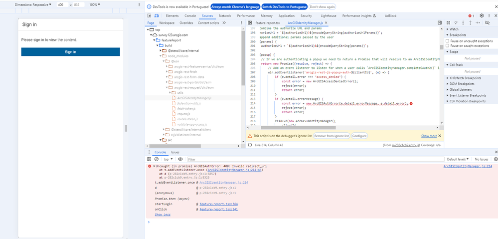

By adding the locale parameter, I can see the login page. However, even after logging in, I still see the 'start session' page, both in "locale=en" and "locale=pt-pt". I tested in both browsers, in the incognito tab and on my phone, and the behavior is the same.
Inspecting the page after starting the session, I have the following scenario:

Now, without any locale parameter, the login page appears directly. However, I still have the same problem reported before: I click to start a session, a pop-up window opens to log in, I log in and nothing happens. The same thing happens in Chrome and Edge, in the normal and incognito tabs.
Below, a video demonstrating the problem:
(the login page in the pop-up window does not appear because I have already logged in previously. But, the first time, the login page for my portal appeared and I entered the access credentials successfully)

Thanks for the screen recording which helps us understand the details of the issue. We have applied a potential fix on the production website for the report page when signing into an ArcGIS Enterprise in the latest September Update 2024, could you try again and let us know if the report page can work for your portal?
