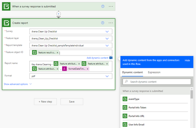

Do you want to create beautiful PDF reports of your survey results? Create your own Survey123 report templates including maps, tables, photos, signatures and more. This release, adds a new Create Report action to the Survey123 Microsoft Power Automate module. Automate the generation of reports on a schedule or when a survey is submitted!
The screenshot below shows a Microsoft Power Automate flow. When an inspection is sent, it creates a PDF report and adds it as an attachment to an email.
Trigger the Create Report action when a survey is submitted, as in the example above, or schedule it to run daily, weekly, etc.

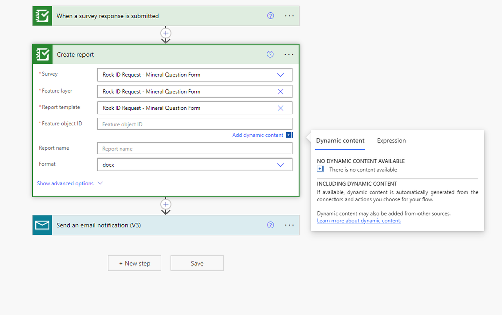

DickieRigdon
@RobertAnderson3 Unfortunately, my Survey elements do not appear in the Dynamic Content. The Create Report does see my survey in the first question (*Survey) but the rest of the dropdowns do not populate with any suggestions.no dynamic content avail.png
RobertAnderson3
MVP Regular Contributor
@DickieRigdon
The create report is only for if you actually want to create a report from the data for the email, I just screenshotted the webhook I happened to be working on haha.
I've run into this issue before, if you're missing a label in ANY of the fields, questions or groups or repeats, it for some reason prevents the dynamic content from loading. (You'd get a warning when you save the XLS form and it updates in Connect) Could that be the issue?
DickieRigdon
Hi @RobertAnderson3 ,
My overall workflow currently is just a) Survey123 form is submitted > b) Power Automate Webhook is triggered> c) Alert Email is Sent notifying a form has been completed.
Looking at one of the recent tutorials, https://www.esri.com/arcgis-blog/products/survey123/constituent-engagement/instantly-load-survey123-...
maybe I need to create an Excel document and insert into my workflow.  Is that step required for Power Automate to pull the Survey123 participant's name off the form?  The Excel step would definitely be helpful for the person receiving the alert emails.  They want to be able to track and check off the form submissions that have been answered/closed.  Thanks again, Dickie
RobertAnderson3
@DickieRigdon
You shouldn't need to add any other peices, you could absolutely include an action to make an Excel as well (this actually just gave me an idea for a workflow of my own I've been looking at) but it always just got added in for me. With the changes recently and looking closer it might be something with the advanced options settings in the trigger.
You might need to make sure that these are set to 'Yes' specifically the 'include submitted record'. There's more details on the way the connector works here:
https://learn.microsoft.com/en-us/connectors/survey123/#when-a-survey-response-is-submitted
If it's still not working beyond this then it might be a thing for Ishmael as I'd be out of ideas haha
