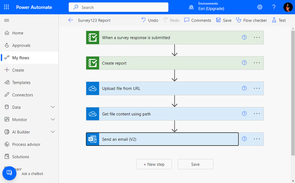

Do you want to create beautiful PDF reports of your survey results? Create your own Survey123 report templates including maps, tables, photos, signatures and more. This release, adds a new Create Report action to the Survey123 Microsoft Power Automate module. Automate the generation of reports on a schedule or when a survey is submitted!
The screenshot below shows a Microsoft Power Automate flow. When an inspection is sent, it creates a PDF report and adds it as an attachment to an email.
Trigger the Create Report action when a survey is submitted, as in the example above, or schedule it to run daily, weekly, etc.
To learn more about Survey123 reports, check this help topic. To get started with the Survey123 and Microsoft Power Automate, check this article.

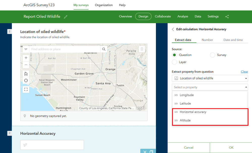

Use the Survey123 web designer to visually create forms right from your web browser. In this update, calculations on map questions have been enhanced so you can collect the horizontal accuracy and altitude of point locations.
Use these new options to record additional metadata about locations collected in your survey. Tip: Calculate these values and hide the question from your survey. This way, you collect important metadata while keeping the form simple for your users.
