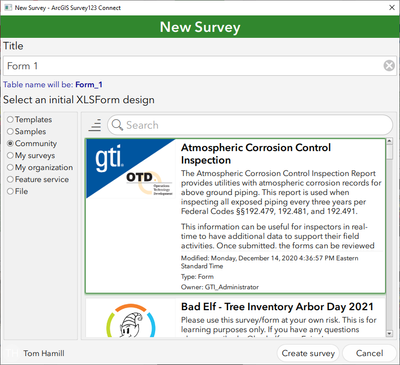

ThomasHamill
What's the process for publishing Survey123 XLSForm designs to or getting them approved for the "Community" section shown in Survey123 Connect?
Jim-Moore
Hi @ThomasHamill thanks for your comment. As it turns out, the Survey123 team is currently formalising a process that will allow anyone to submit one of their own surveys to be reviewed and then made publicly available in the Community samples section in Survey123 Connect.
We plan to publish a blog post with further details on this process in the coming weeks, so please keep an eye on the blog.
