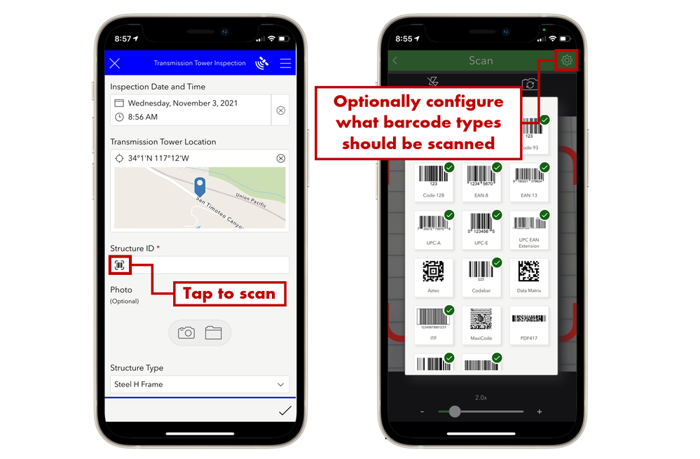

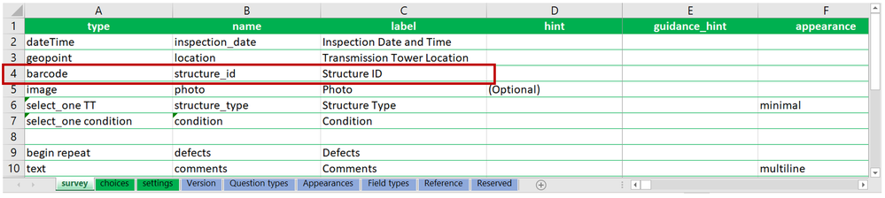

If you would like field users to be able to scan a barcode and get the data added to your survey, you need to add a barcode type of question. As shown in the screenshot below, the XLSForm specification includes a barcode question type.
Barcode questions, by default, are shown in your form as an input box with a barcode scanner button o the side. Users can either manually enter text or tap the scanner button to trigger the device camera.  By simply focusing on the barcode the barcode will be scanned and the data from it added to the form.
Survey123 supports the following barcode types: QR Code, Code 39, Code 93, Code 128, EAN 8, EAN 13, UPC A, UPC E, UPC EAN Extension, Aztec, Codabar, Data Matrix, ITF, MaxiCode, PDF 417, RSS14 and RSS Expanded
By default, the Survey123 field app will automatically scan all barcode types except Code-39 and PDF417. If you need to scan Code-39 or PDF417, go into the scanner dialog settings and activate the format you are targeting. Your barcode preference will be remembered.

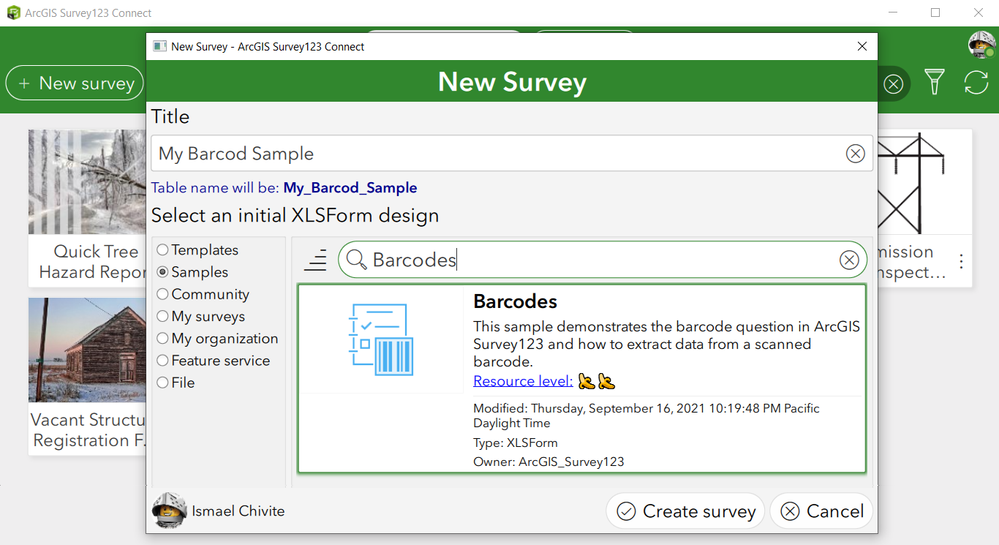

To help you get started, Survey123 Connect includes a Barcodes survey design sample. Open Survey123 Connect, click on New Survey, and then look in the Samples category. Publish the survey and download it into your device to familiarize yourself with the XLSForm syntax and the app experience.

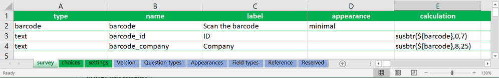

Barcode questions in Survey123 support the minimal appearance. When used, the question will not show any type of input text box. Instead, all the user will see will be the name of the question, as well as the button to start the scanner.
The minimal appearance in a barcode question is typically used in combination with calculations in other questions: the barcode question is used to fetch data, and the calculations extract that data and display it to the user.
Say for example you want to use a barcode to store the Unique Identifier of an asset and the company that produced it. Just like in the barcode on the side.
We would not want to show all that information in a single field, because it would be confusing to the field user, and somewhat useless stored that way.
Using the minimal appearance and calculations you can parse the information from the barcode and present it and store it in different fields... like in the following example:
If the information in the barcode is more complex, you can use a custom JavaScript function to parse its contents.
