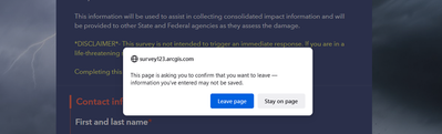

leaveDialog
Use this value if you do not want the web browser to request user confirmation before leaving the web browser survey page.

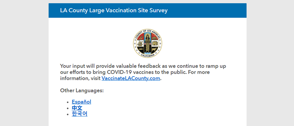

Set the language of your survey (locale)
You can use the locale parameter to define the language of your survey. For more details on mutiple-language surveys refer to https://community.esri.com/groups/survey123/blog/2019/01/23/introducing-multiple-language-surveys
The locale parameter accepts ISO language codes. For example: locale=zh-cn  or locale=en.
Below is a clever example where this parameter is used to help end users switch the language of the survey right from within a note in the form.  You can see the different links added. Each of these links uses the locale parameter to reload the form in a different language within the web browser.
