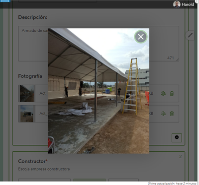

Hi all.
I have some trouble when the users are editing images question. When they click over the images, the interface gets a freeze, and the window can't scroll down or up...

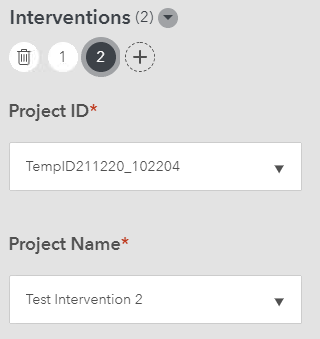

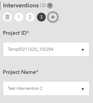

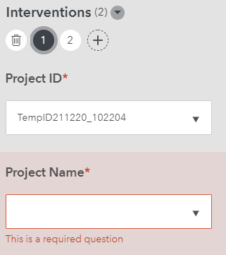

Hi,
I've tried implementing the URL scheme to edit existing surveys with repeats and worked just fine. However, one of my fields within the repeat can only pull one value (last repeat). This field uses the search() appearance and is pulling values from another feature service. All my repeats display the same value for Project ID in the form edit mode, but from the data view, it contains correct values - I checked this by pulling each values from the repeat and displaying them in another field.
When a new record was added, the same behavior happens. The field gets populated with the value from the last repeat.
Thanks,
Patricia

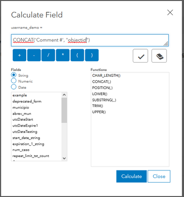

@IsmaelChivite @JamesTedrick is it possible to recalculate a single field for all submitted surveys at the same time? Rather than having to paste each global id one at a time?
RViruet
You could do that using the calculate fields operation, @AJ_devaccount
AJ_devaccount
@RViruet @IsmaelChivite @JamesTedrick Unfortunately my calculations uses the object id, and that can only be calculated post submission. Calculate field won't enable bulk post submission calculations it seems.
RViruet
@AJ_devaccountMy apoligies, I wasn't specific.
I meant using the calculate fields operation on the FeatureLayer. Since you want to calculate for all current records, you could do something like:
