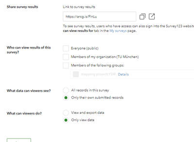

Create a view for the Survey123 website first
I said before you will want to create at least two views: One for users who will look at your survey results through the Survey123 website, and another one for users to submit data through the Survey123 web and/or field apps. It is best to start with the view to control access to the survey results.
To build the view:
  • Login into the Survey123 website
  • Navigate to the Collaborate tab of your survey
  • Switch to the Share results panel, select who should have access to your survey results and what privileges you want to grant to these users. Click Save.
If you return now to the Survey123 folder under Content in ArcGIS.com, and refresh it, you will notice that a new view has been created for your survey. This view has a 'stakeholder' suffix.
This new view will control who can use the Survey123 website to look at your survey results.  You will want to use the Share results panel in the Collaborate tab of the Survey123 website to control this. For example, say that users in a group called 'City of Cilantro' need to be able to look at the results of your survey, create reports and download data. Then you will go into the Collaborate tab, switch to the Share results panel and share your survey results with that group. At that point, 'City of Cilantro' users can log into the Survey123 website and use the Overview, Data and Analyze tabs to do what they need.
I would not recommend that you modify the sharing of this newly created view through ArcGIS.com. For the Survey123 website to properly work, the sharing of the Form and stakeholder view items must be in sync.  The Collaborate tab in the Survey123 website takes care of that.

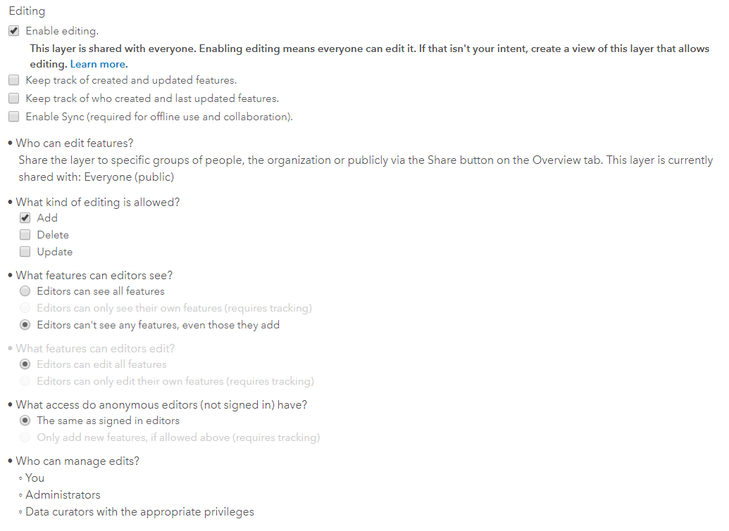

Configuring the view for the Survey123 web and field apps is a bit more involved. We need to create this view manually, then associate the view with the Survey123 Connect survey.
  • Log into the arcgis.com website and click on the My Content tab.
  • Click on the Form item to open its item details page.
  • Look for the Layers section and click on your survey feature layer link. This will open the item details page for your surveys feature layer.
  • Click on Create View Layer. You can choose any title for your feature layer view.
  • Go into the Settings tab
  • Enable Public Data Collection and save.
  • Make sure Enable editing is checked and save.

Secondly, because I use a none-hosted feature service I cannot choose ”Only add new records” under “What can submitters do?” If I want to successfully save my settings the only option is “Add, update and delete…”
Is this a limitation when using a none-hosted feature service (FS linked to SDE database)?
