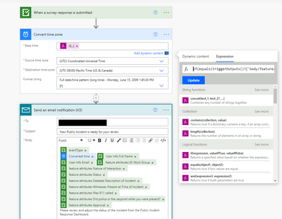

I had a similar problem, but with multiple date fields and found this expression worked best without having to Add Time or Convert Time Zone within Power Automate:
convertTimeZone(addSeconds('1970-01-01',div(triggerBody()?['feature']?['attributes']?['dateTimeSubmited'],1000)),'UTC','Pacific Standard Time','g')

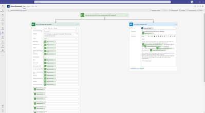

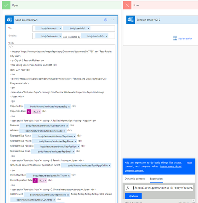

I was having issues with null values in my date fields using Survey123 with webhooks and Microsoft Power Automate. I am using an if statement in combination with the formatting like so...
if(equals(triggerOutputs()?['body/feature/attributes/InspDate'],null), 'No inspection date recorded', convertTimeZone(addSeconds('1970-01-01',div(triggerOutputs()?['body/feature/attributes/InspDate'],1000)),'UTC','Pacific Standard Time','D'))

JeffLegato1
@Anonymous User I am using Survey123 version 3.14.242 loaded from a direct link from a feature popup in Field maps.
My issue is resolved using the if statement in my earlier post.
VanessaSimps
@JeffLegato1 Quick question for you- and thank you for posting your if statement! This is super helpful. I was able to mimic what you used in my work.
  1. Were you still using the Convert Time Zone step in your workflow as shown in this screenshot, or were you doing something else?VanessaSimps_1-1663622248218.png
  2. what is the 'D' used for in the last part of your if statement?
I was able to get what you shared to work, except that the date that is returning to me now is a just under a day (about 22hrs) behind what is in the survey? wondering if I missed something in the steps??
thanks in advance!
Vanessa
JeffLegato1
@VanessaSimps The 'D' is for the Long Date Pattern see: https://learn.microsoft.com/en-us/dotnet/standard/base-types/standard-date-and-time-format-strings#R...
I am not using the Convert Time Zone step. The if statement is contained in the email body to include specific text if the date is null or the date if a date was recorded in the form.
VanessaSimps
I think I figured it out. Thank you again for posting your solution. I don't think I need the null part right now, but it is really useful to keep in the back pocket!
