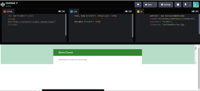

  • Programmatically embed a Survey123 web form within a web page at run-time.
  • Apply a custom css to the embedded web form to make it look fit within your own web app.
  • Programmatically read and write values into the embedded web form from your own web application.
  • Subscribe to web form events such as onFormLoaded, onFormSubmitted or onValueChanged.

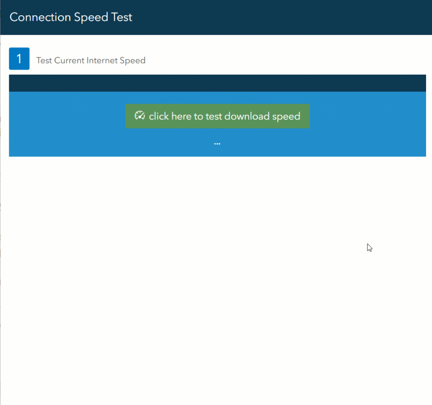

There are many applications for this new API. In the animation below, for example, a form is embedded within a web page used to report the speed of your internet connection. When the page is initially loaded, a big button is shown to help users initiate a quick internet speed test. One the connection speed is estimated, a Survey123 web form is loaded and the output of the speed test is automatically added into the form. At that point, the end user can complete the remaining questions and submit. The whole idea with this is that the logic to measure the internet speed of your connection sits in your web application, but when the time comes to submit data like your location or email contact, a Survey123 form is used for that. Through the Survey123 web app JavaScript API you can make your web app talk to the form and load the measured internet speed right away to make the process simpler.
Thanks to the Applications Prototype Lab for sharing the above example and making its source code available in GitHub!

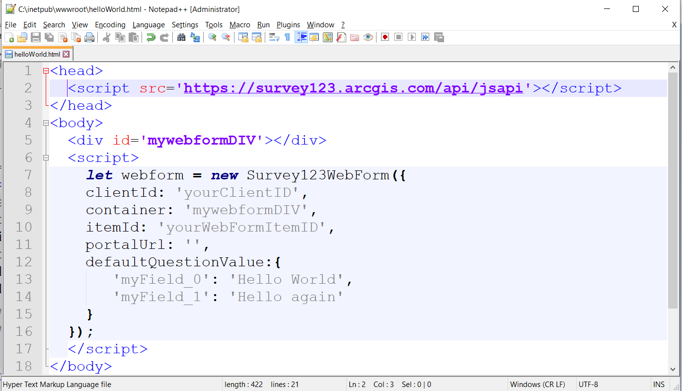

The following is about the simplest code snippet showing the basics of the Survey123 Web App JavaScript API. This sample loads a custom web form into a web page and pre-populates a couple of questions in it.
Lets have a closer look at the code:
  • Line 2: In this line we import the Survey123 web app JavaScript API. The address of the latest version of the API is http://survey123.arcgis.com/api/jsapi
  • Line 5: Your web form needs a container in your web page. Typically, you will want to use a DIV HTML element. You can control the exact size of the the container in your page, although keep in mind that you cannot make it too small or otherwise your web form will not have room to display.
  • Lines 7-14: This is where we create a Survey123WebForm JavaScript object. The constructor requires at least the following attributes:
    • clientId: The client ID is a string that proves that you have explicitly authorized the use of Survey123 web app API from your web page. You need to create the Client ID through the https://developers.arcgis.com/ website. Check the Generating a Client ID section later in this article for details.
    • container: This is the HTML element in which you want your web form to be displayed. Typically a DIV.
    • itemID: This is the ArcGIS itemID of your web form. Check the Getting the ItemID of a web form section later in this article for details.
    • token: This attribute is only needed if you are targeting a private survey.
There are a number of optional attributes you can also set. In the example above, we added the defaultQuestionValue attribute to set the default value of a couple of questions.  Check the Web Form attributes section later in this document for a complete list.

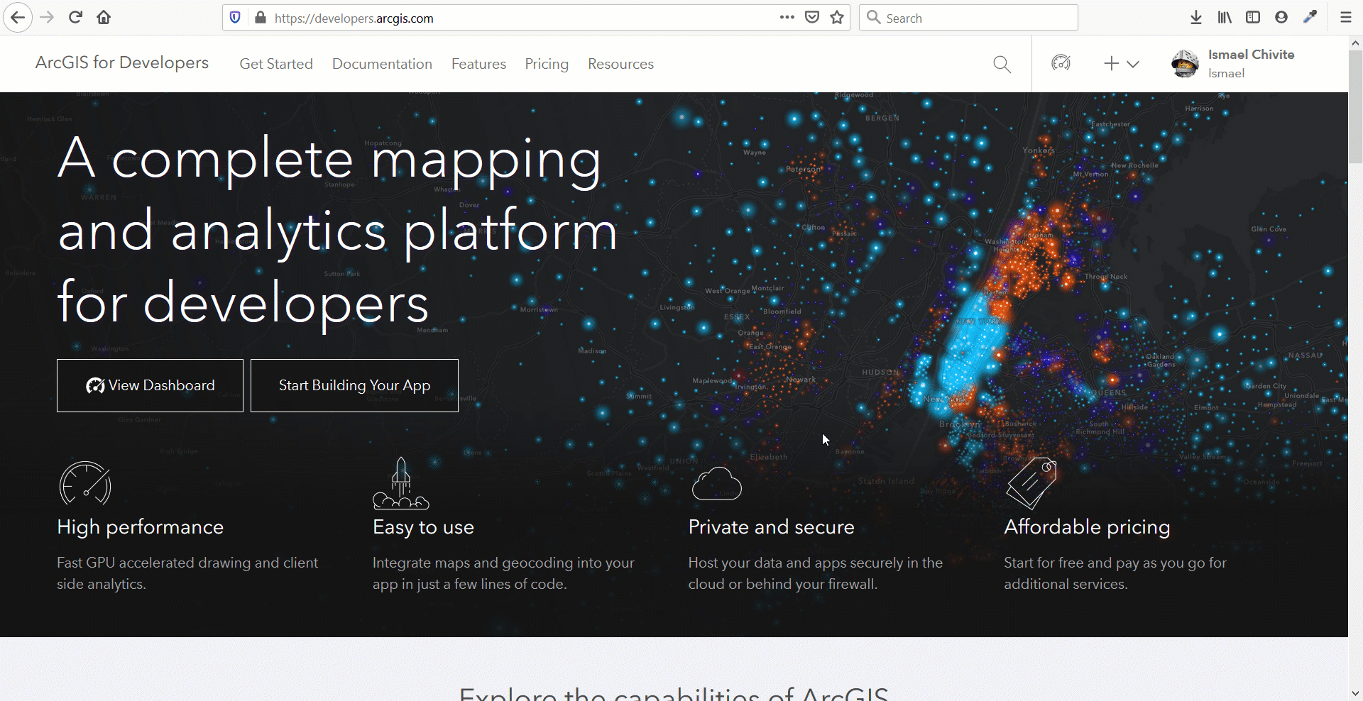

To authorize the use of the Survey123 web app JavaScript API within your web application, you must provide a valid Client ID. You can create a Client ID through ArcGIS for Developers  as follows:
  1. Login into ArcGIS for Developers and open the Dashboard.
  2. Create a New Application and switch to the Authentication tab
  3. Add your web application URL and/or domain to the list of Redirect URIs.
  4. Copy the Client ID.

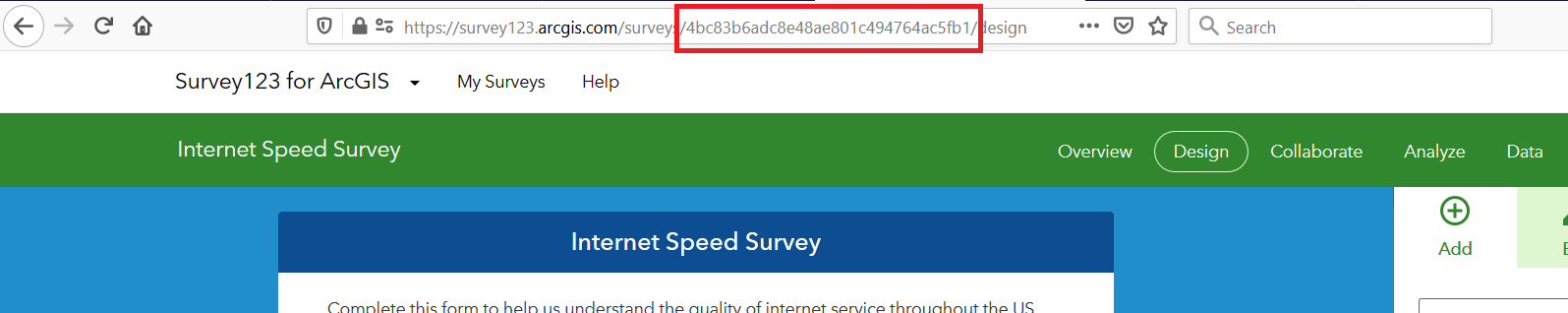

Getting the ItemID of a Web Form
ItemIDs uniquely identify ArcGIS items within your organization. You can find more information about itemIDs in the https://community.esri.com/community/gis/web-gis/arcgisonline/blog/2019/06/06/where-can-i-find-the-i... article. To get the ItemID of your web form:
  1. Login to Survey123.arcgis.com.
  2. Open the Overview or Design tab of your survey
  3. The portion in the URL highlighted in the screenshot below is the itemID.

  • Hello World: A bare bones sample showing how to embed a web form within a web page.
  • Speed Test: A more elaborate sample written by the Esri Geo Experience Center’s Applications Prototype Lab. It integrates a simple routine to estimate internet speed connection and then uses that estimation to pre-populate a question in a web form.

Does anybody know why my example looks like this? I mean, I have created the same example as this link https://www.youtube.com/watch?v=7Yyn-bqpCNc , but the frame just shows me a part of the screen.
AdrianDoss
Yes, I have the same issue.
