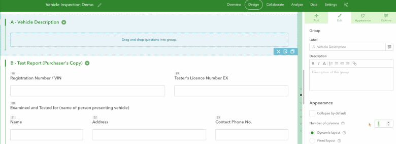

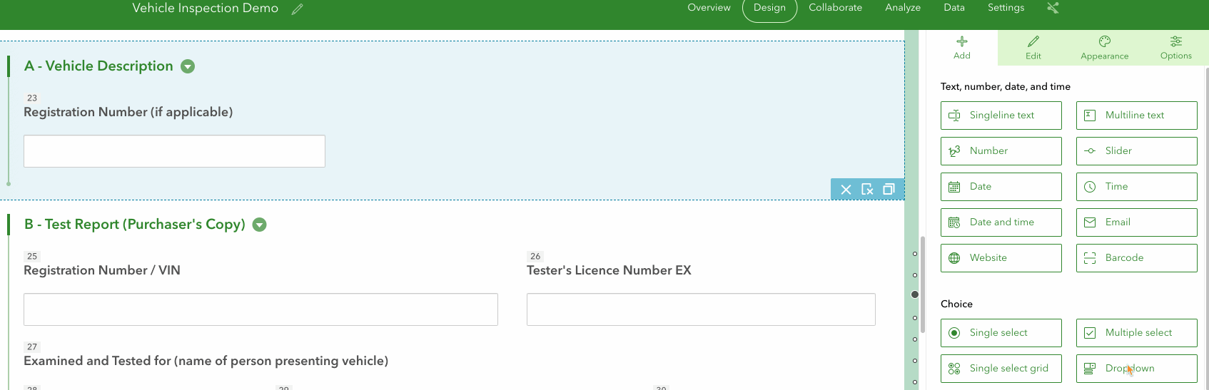

1. Increase column number of pages and groups to start using grid layout.  In below example, setting it to 8 divides each row into eight columns of equal width. By default, groups and questions occupy one column each.

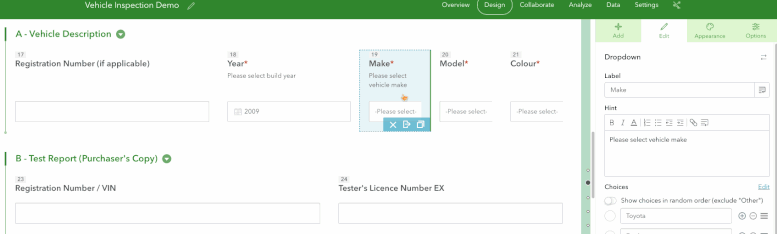

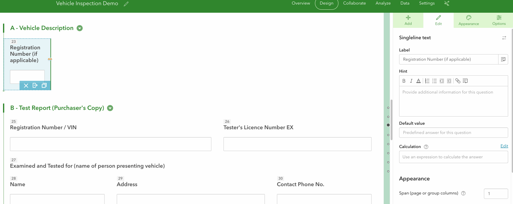

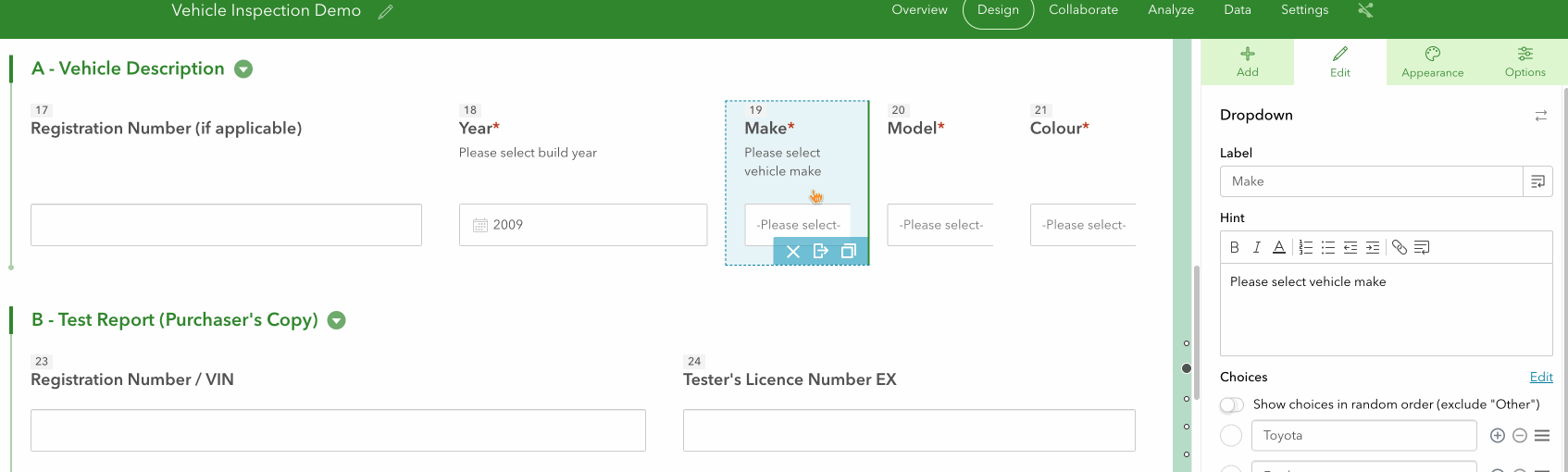

2. Span property is introduced along with column and it controls how many columns from the page or groups our questions occupy. Similar to below example, we could drag the end of question horizontally and stop when span is 3. It means this question occupies 3 columns of its containing group.
Limitation: when there is only one page in web designer, we couldn't adjust spans of questions outside of groups.

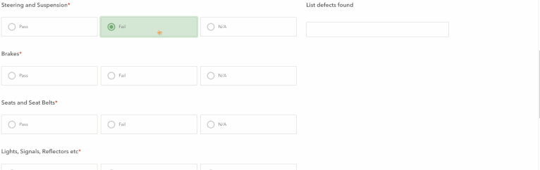

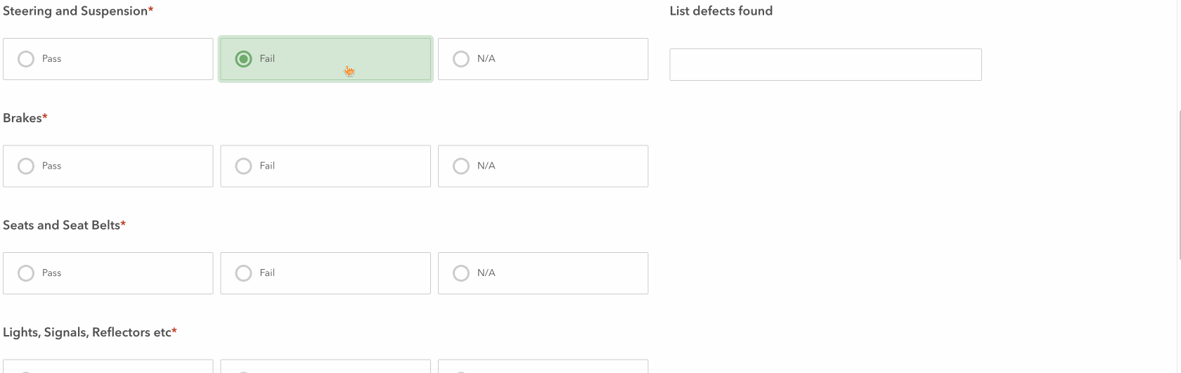

Grid layout style controls behavior of questions in groups and pages. The difference between fixed grid and dynamic grid styles is how questions are positioned within the grid. When using the dynamic-grid style, questions and groups may move around on the form in an attempt to make best use of the available screen space.  The fixed-grid style is more predictable. A question will appear if its relevant/visibility conditions are met, otherwise a blank space will occupy that part of the form.
Below is an example of using fixed grid layout, there is a placeholder created for question - List defects found  and this question won't appear until choice of Fail is selected. No questions will move to fill available space.

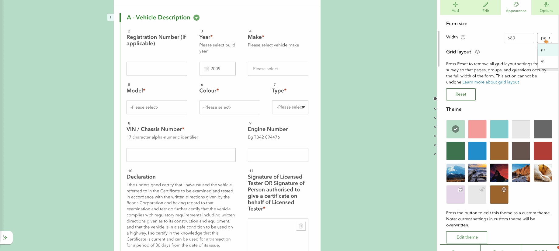

Adjust form width to improve your grid layout
Form width can help ​improve how the web app displays a grid layout and can be set in pixels or as a percentage of screen width.  Increase form width to fit more questions in a row.
For example, I have set form width to be 100% below and it enables this form to take full width of my screen space.
