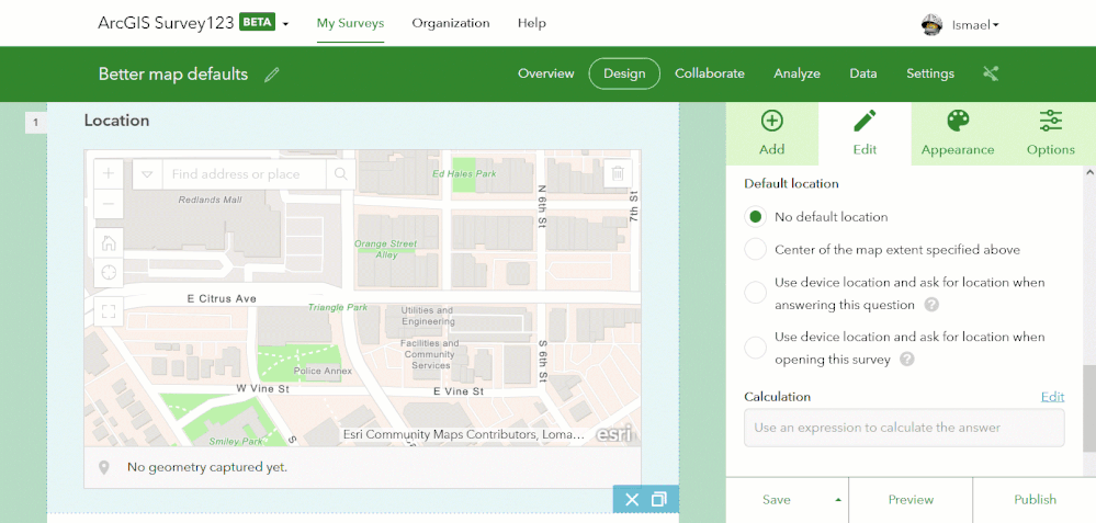

Better map defaults
Controlling how the location of a map is set is important. We added new default options in 3.14 beta:
  • No default location—Use this if you want your map question to have an empty default value. Typically, when you choose this option you will also want to make the question required. In this way, the respondent must always answer the map question.
  • Center of the map as specified above—The author of the survey defines a fixed location as a default answer to the question and the map is centered around it.
  • Use device location when answering this question—The map will automatically center and set the answer of the question to the user's location. If the user does not interact with the map question, the value will be empty.
  • Use device location when opening the survey—The map question gets the user location automatically when the survey is loaded in the web browser.

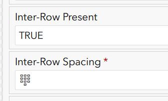

Edit: I realize "theme-grid" is not an option anymore, in favor of "dynamic-grid".
Hidden fields are showing in theme-grid, same with relevant.
