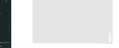

I have been working on a storymap item. Since this evening, none of the web maps were loading when I tried to edit the map frame although the layer items are showing up properly to the left. Does it occur to anyone else?

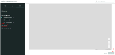

@OwenGeo - Thank you for the suggested workarounds; however I am unable to actually toggle off the legend of the maps within my StoryMap because any changes I make are unable to be saved. Cancel is my only option as "Place Map" option is grayed out.
I also tried disabling legend in each layer of the web map referenced and still am unable to load a map, even when all layers are visible.

@KalinDrennen --  I see. I believe that you'll have to avoid the situation that causes the maps not to load while making your changes. You can do this by reloading the builder and going right to the first map you need to edit. If you need to adjust another map, you may need to reload the page again and go right to the next map and repeat this as needed. I'm sorry for the inconvenience.
I'm just about to post a note to the community blog that we will be fixing this issue in a patch on Monday.
