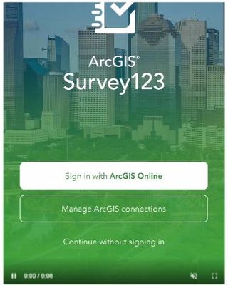

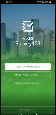

I have added a video to one of our StoryMaps, but it is cropping the dimensions so that only the middle (horizontally-speaking) of the video displays. The video is a screen recording from a mobile device, so is 'long' vertically. Is there a way of making sure the full screen is shown in the video and not just the middle section?
I have attached some screenshots for comparison of what it should look like (left) vs. how it appears in StoryMaps (right).

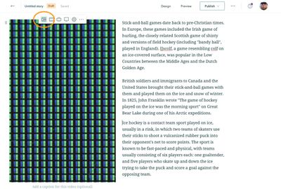

@DataOfficer -- If you'd rather have the video inline in the main part of your story (not in a sidecar media panel), you could try the FLOAT media size option. That may still crop the video a little, but more of it will be shown since the width is much narrower.

Hi @OwenGeo, I did try the float, small, medium and large options but they all crop a large amount of the video window. The right-hand image in my original post above is the video in float mode.
