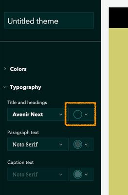

I saw this issue with the mobile, but in this case, I am creating the story for the third part and they want their image instead of the title. They do not like the untitled tab as well. So I am stuck a little bit. I was thinking about changing the colour of the title to the same as the background, but there are no possibilities to edit the colour of the title either... 🙂
OwenGeo
Esri Notable Contributor
@BrianMoT -- In the theme builder you can choose the title/heading color under typography.

@OwenGeo - thank you it could help
