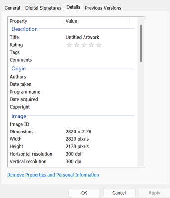

I'm a little confused about where else to check for this - but I have an image with these properties:

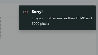

But I'm still getting this message:
I've tried anything I can think of - closing out of the program, clearing out the browser cache, trying a different browser (I'm currently in Chrome). It's a PNG file, which should be compatible. I even tried copying the file and uploading the copy instead in case that was the problem. But now I'm not sure what else to try.
The only thing I can think of is 5000 pixels means a total count between height and width (instead of 5000x5000) OR even though it says the file size is 9.61 MB, the byte size is still registering as high (10,084,264). I'm trying to avoid reducing the picture visually as much as possible because it has a lot of colorful details.

I suspect that the the image is just a bit too big. Try reducing the resolution a bit, or cropping it slightly, to get a smaller image.
SaraJL
I reduced it from 9.61 to 9.48MB and that seemed to work (thank you Microsoft Paint!) I wonder if there is some type of background process that is adding the extra information.

In my experience, StoryMaps does not correctly enforce the 10MB limit. Instead, it appears to checking to see if the bytes value is greater than 10,000,000. (10MB does not equal 10,000,000 bytes, but rather is equivalent to 10MB x 1024 kB/MB x 1024 bytes/kB or 10,485,760 bytes.)

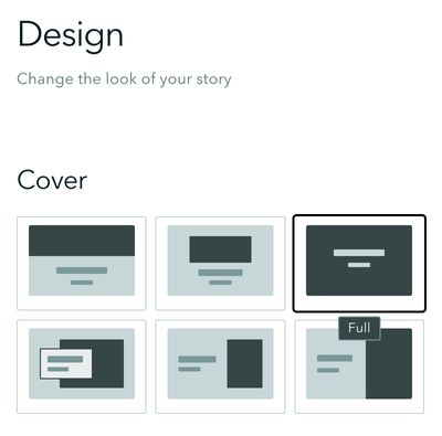

@SteveCole -- Can you share more info about what you are looking for related to having a full screen video playing on the cover? ArcGIS StoryMaps has six different cover styles, including a full-page layout. They all support video. Please let us know how these are not meeting your requirements so we can take a look at future enhancements!

Owen- I now see what you're talking about. I would suggest moving that "Design" button functionality into the Story Map Settings inside the three dots. It wasn't intuitive to me to click on that, for that functionality, when I was looking for options.

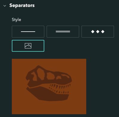

@SteveCole - The "title section" from the classic Cascade template was not included in ArcGIS StoryMaps in favor of having the ability to include a custom separator image as part of the theme. You can add separators between story sections right before each heading to provide some visual interest and consistency across a story. This version is a bit simpler than the classic feature, but offers improved accessibility and readability. For more info, see this tutorial.

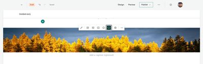

If you'd like something larger, or a different image for each section, you could create your own wide, thin banner images and add them to a story using the LARGE block size so they go from edge to edge. There isn't a way to add text on top of them (and I would not recommend burning text into an image since that is not accessible), but this would otherwise look very similar to the classic title sections.
