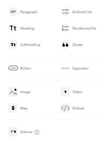

Hi,
I'm using an ArcGIS Enterprise 10.8.1 setup, and am looking to create a Story Map Map Tour as referenced in this document:
Add map tours—ArcGIS StoryMaps | Documentation
However, when I add a new block I am unable to see the Map Tour or many other interactive block options, see below:
Available block optionsAvailable block options
Am I missing an update for Story Maps somewhere that has the Map Tours functionality? Or is it a capability only in ArcGIS Enterprise 10.9?
Thanks,
Henry

@Henry -- In Enterprise 10.8.1, the map tour and express maps features of ArcGIS StoryMaps are only available if the Living Atlas is also enabled on your Enterprise portal. This is due to a requirement that the basemaps provided by the Living Atlas are available.
In 10.9, this restriction was alleviated, so map tours/express maps are available because you can use your own web map to provide a basemap in the Web Mercator projection.
