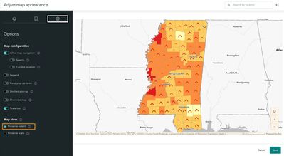

@lzk222 -- There is a map configuration that is useful for situations where you want the exact extent of your map to be preserved when others view your StoryMap. In the map options, make sure Map view is set to Preserve extent. If that is the case and you still see different extents on different screen sizes, please provide the link to the story so we can investigate.
