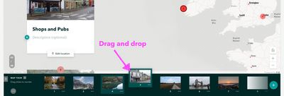

HI @JR5 -- Welcome! It's always great to have new additions to our community.
  • If you've created a tour manually, you can simply drag and drop the slides to whatever order you'd like.
  • Currently, all tour points will be the same color, but we are looking at additional symbol options for tours in a future release. You might want to vote for this idea that's been submitted to our ideas board to register your support for this enhancement.
