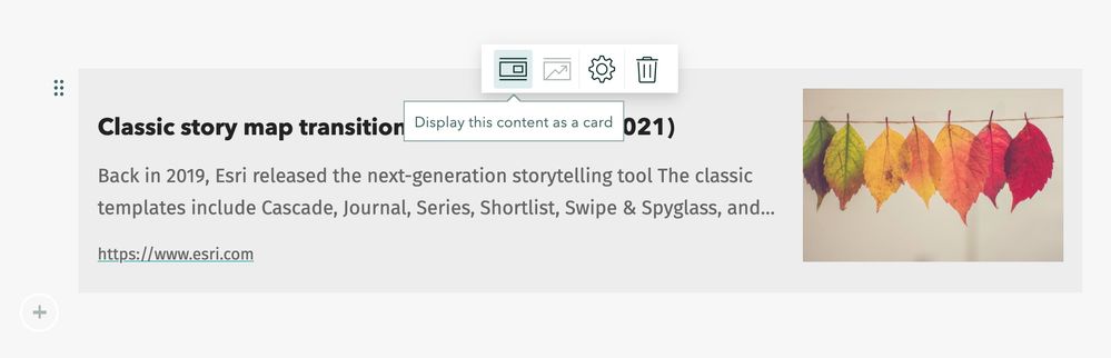

For now, the recommended way to add "better" links (not just a text hyperlink) to a story is to use the Embed option and choose to show your embed as a card. Cards are nice looking links with a thumbnail, title, and description (screenshot below). In some cases, adding a hyperlink to some text in an image caption can also work well.
