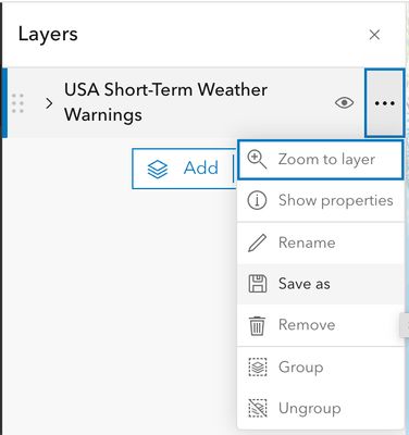

OwenGeo
@Thomas1 -- Popups and other layer configuration can be saved to a layer item and reused across any number of web maps or web scenes as needed. You can do this using the Save as option in the map viewer. The new layer item references the data, so if the underlying information changes, that is still reflected when using the layer item.
If you and your colleagues have invested time in configuring layers with good customized pop-ups and layer styling, I would recommend considering this technique to save that information to layer items so it can be more easily reused outside a single web map.
For more information see Save and duplicate layers—ArcGIS Online Help | Documentation and Save a copy of a layer | Documentation.
I hope you find this information helpful!
