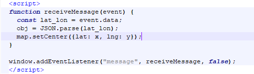

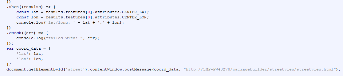

Sorry. Just wondering if anyone had any suggestions on transferring data extracted from an arcgis rest service to an iframe that I am locally hosting:
I am not sure if the postmessage is being sent because there is no callback although I believe it is going through. The event listener I know is wrong and needs work.

Brandon Price‌, i don't have my working computer with me so its hard for me to get some sample code but basically there are a few options.
you can pass data via localstorage
you can alternatively also use javascript, see a old code example of my
var win = window.open(this.widgetPath + "StreetView.html","_blank",
                    "width=" + this.config.svWidth + ",height="+
                    this.config.svWidth+",TOP=0,LEFT=0");
                if(!win){
                    alert("Make sure your pop up is unblocked");
                    return;
                win.onload = function() {
                    var point =  new Point(evt.mapPoint.x,evt.mapPoint.y,me.map.spatialReference)
                    win.initialize(0,point.getLatitude(),point.getLongitude());
                    win.setPanoramaCallback(lang.hitch(me,callback));
                    win.setPositionCallback(lang.hitch(me,me.callbackPositionChange))
                    win.setClose(lang.hitch(me,me.closeThisWidget));
in your iframe
 function initialize(heading,lat,lon) {
        var pegPoint= {lat: lat, lng: lon};
         panorama = new google.maps.StreetViewPanorama(
            document.getElementById('pano'), {
              position: pegPoint,
              pov: {
                heading: heading,
                pitch: 10
