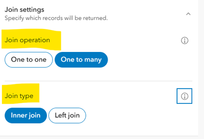

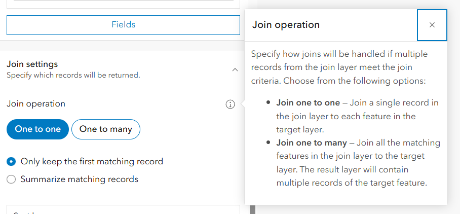

Hello. I'm attempting to create a Joined View via the ArcGIS API for Python and ArcGIS REST API. I've seen examples that say to first use create_service() to create an empty feature service (with is_view=true) and then use add_to_definition() to add layers and set up the join via "relatedTables". Within the relatedTables is a "type" property to set the join type (LEFT, RIGHT, INNER, FULL), but I haven't found anything on how to set the join operation, aka join relationship (one to one versus one to many).
If I go to create a Joined View manually in ArcGIS Online there is an option for it, but I'm unsure how to set this via the API. I've also been unable to figure out how/where to check for this property on existing views that have been created manually (was hoping I could find the property that the API wants from there). There doesn't seem to be anything related to that in the service JSON, though.

AaronKoelker
@RyanUthoff Thanks for the link Ryan, that is one of the examples I'd looked at but I don't believe it answers my question. I believe the type of join (left, right, inner, full) is separate from the join relationship or cardinality (one to one (1:1) versus one to many (1:M)), though I could be mistaken. When you go to create one of these manually in the builder, those are two separate questions/settings. In the documentation, the only values listed for the "type" property are LEFT, RIGHT, INNER, FULL
I expect that it treats it as a 1:1 join by default, but unsure how to tell it I want a 1:M.

AaronKoelker
@RyanUthoff Your suspicion was on the right track, and the support article you linked originally was updated after I submitted a feedback request for Esri to clarify the article (scroll to blue note at the very bottom). Omitting the entire "topFilter" section will have it behave as a 1:M, although they did caveat that the behavior may not be entirely reliable. Which is a little odd to me considering it is an option in the UI when creating a Joined View manually in ArcGIS Online.
