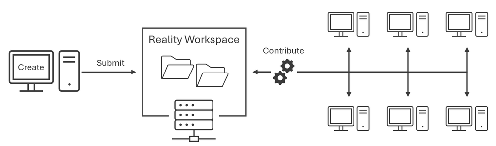

Creating a workspace in ArcGIS Reality Studio is straightforward. A workspace is simply a folder at a centralized location, accessible by all contributing nodes. Because of this, it is trivial to create multiple workspaces to have clusters working in parallel. A workspace is a central hub where all processing tasks and data are stored.
To create a workspace:
  1. Create a new folder at a location that is accessible to all processing nodes
  2. Done! (see how simple this is?!)
There is no extra software needed, no complicated configuration... we just need a basic folder, and your workspace is ready for use.

Connecting Processing Nodes to a Workspace<!--
With the workspace set up, it is now time to connect each of the processing nodes to it. As we have already installed the software, it only takes a few clicks to start Reality Studio and connect each of the machines to the workspace you created:
  1. Start the ArcGIS Reality Studio application and from the start page select Distributed Processing.
  2. Verify that the temporary processing location has been set correctly and that there is sufficient free disk space for processing.
  3. Click the Contribute to a Workspace button at the top, select the folder you created previously, and click OK.
That's it! Reality Studio will now automatically connect to the workspace and look for available tasks to process. Repeat these steps for all your remaining processing nodes.

Submitting Jobs to a Workspace
Most of the time you will be working with Reality Studio on your personal workstation. When creating new reconstructions, you can now select the workspace you just created when defining your reconstruction settings. Make sure to finish with Create and Submit to add this reconstruction to the job queue of the workspace.
If you have only created the reconstruction within your Reality Studio project, you will find the option to submit it within the Reconstruction ribbon. This is also where you can cancel a reconstruction, which will stop all processing and withdraw the reconstruction job from the processing queue. Doing so preserves the progress of your reconstruction and you can then resubmit the reconstruction at any time to resume processing, which will place it at the end of the job queue.
