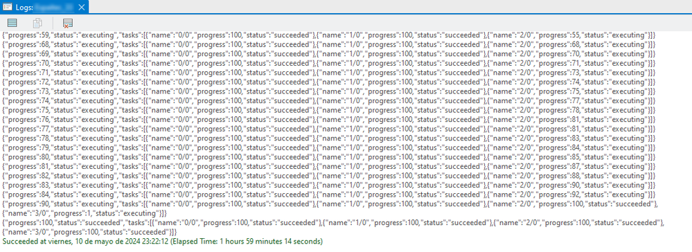

  • On the other hand, the logs that now appear in the log tab are quite confusing/strange, since they do not show anything about the process that is being done:

Thanks for the feedback. What was the total size of the images processed? Are you able to share the data for testing? In regards to point#2 I will share your feedback with the dev team. Thanks again.
