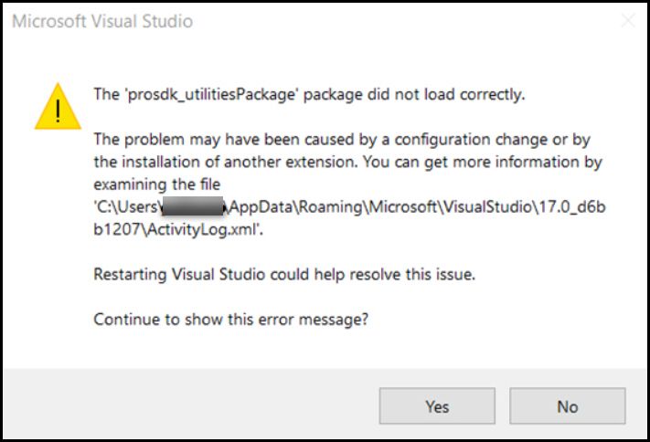

Additionally, with earlier versions of Visual Studio, you may encounter the following message when installing the Pro SDK prosdk_utilitiesPackage.vsix for 3.0.  Simply click “No” to continue and consider updating your Visual Studio 2022 version.
Visual Studio error message, a version update to 17.2 or newer is recommended:
