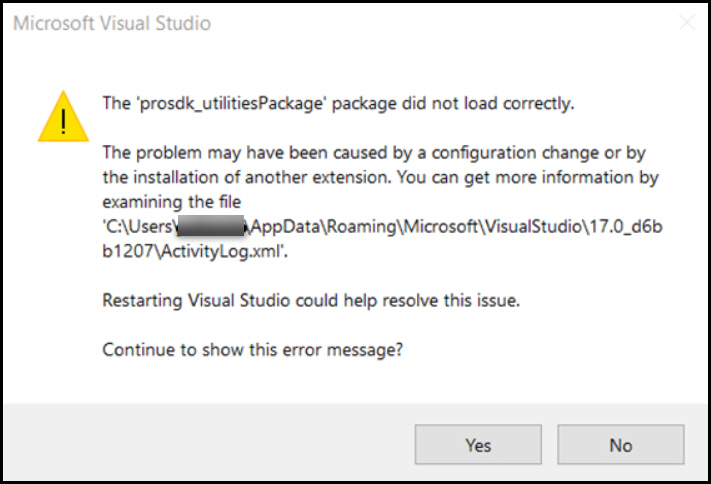

Additionally, with earlier versions of Visual Studio, you may encounter the following message when installing the Pro SDK prosdk_utilitiesPackage.vsix for 3.0. Simply click “No” to continue and consider updating your Visual Studio 2022 version.
Visual Studio error message, a version update to 17.2 or newer is recommended:
CopyLocal Issue
If you are using Visual Studio 2022 version 17.1.6 or earlier when compiling your add-ins, you may notice that the CopyLocal behavior of the add-in (or Configuration or Plugin) is broken. Even though Pro assemblies (or any assembly) have the CopyLocal=No attribute set in the property UI, the assembly is still copied local (and added to the add-in archive). To fix this issue, it is recommended that you upgrade your Visual Studio 2022 to 17.2 or newer. After upgrading your Visual Studio 2022, “clean” the add-in project and ensure that the “obj” folder, within the project, is deleted. Check all Pro assembly reference properties in the .csproj or .vbproj and ensure that CopyLocal is set to No. Rebuild the project.

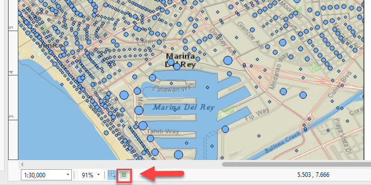

The new Layout Tray Button and Map Tray Button item templates allow developers to create buttons in the tray of the layout and map views respectively. These can be used for running a frequently used command or toggling the activation of tools.
See the new Layout Tray Buttons section in the ProConcepts Layout document, and also the new ProGuide Tray buttons document for walkthroughs on how to work with the new tray buttons. You can also try the new TrayButtons sample which provides a sample application using the new tray buttons.
Screenshot of a sample layout tray button:
