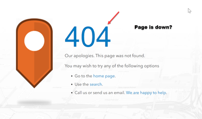

I also tried following the link that Dan provided, to subscribe to the bug report, but hit the same 404 error that he posted a screenshot of. The link worked yesterday afternoon, but not anymore...
