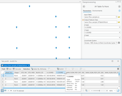

The coordinates are in a projected coordinate system.
I had to use another one for Korea, so the results may not be correct.
Yours isn't listed in the available projected coordinates for Korea.
Here is what I got with what I used.
Back to you to figure out what to use, to make the error go away.

JinseoYoon
Thank you very much!! The problem was in the coordination system as you pointed out. Thank you for making this work!!! I really appreciate it!!!

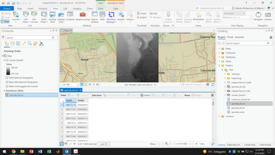

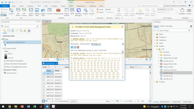

Sorry to crash into a solved issue but I have the same problem trying to display XY data from a table provided (as .txt, as .csv, as .xlsx, I tried different ways)
Data are in European Datum 1950 reference system.
I do not really figure out what is going wrong.
I also point out that, for another project, I could successfully do it some time ago. Then, today I tried to redo the same command and got the same warning message.
Many thanks, alessio
