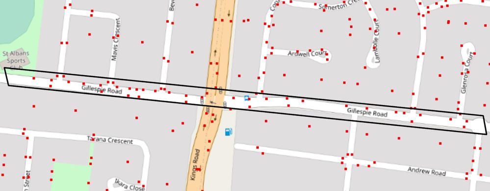

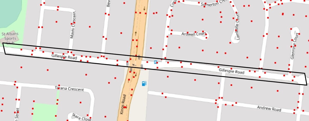

When I run select layer by location between the WFS layer and the AOI attached, I get 0 count.
However, when I run the same selection using the shapefile, I get 49 selected features.

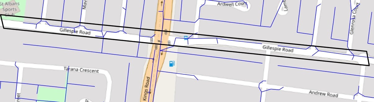

Here is another WFS layer:
https://data.gov.au/geoserver/brimbank-stormwater-pipes/wfs
Access to the shapefile of the dataset:
https://data.gov.au/dataset/ds-dga-a920c6fd-2c34-4b66-adcc-101f49d5e8a8/details?q=brimbank
Similarly, I am expecting 58 selected features, but only 34 features were selected from the WFS layer.
