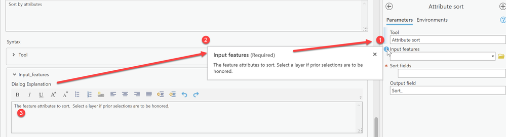

I'm wondering how to create a hint in a script tool?
Specifically this:
The box pops up but I can't figure out how to populate it.

sure can... custom toolbox
You just have to add metadata (below is shown from the Edit metadata view, right-click on your tool in the toolbox and select Edit Metadata)
