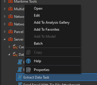

The problem is that I can't found a useful way to publish correctly the GP Service in ArcGIS Pro (specially because I can't copy the Extract Data Task Tool in ArcGIS Pro and it has some details that cannot manage.

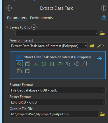

Specially with the Area of interest (that creates a new FC) and the scratchWorkspace parameter.

I just wanted to provide an update on this... We upgraded to ArcGIS Enterprise 11.5 and Pro 3.5
I am now able to publish the Extract Data Tasks (Clip and Ship) again.
