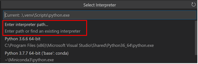

You can use any IDE/Python editor to run arcpy scripts, as long as it allows you to select the ArcGIS Pro python environment for use. For example, I use VS Code, and  can set the environment to the default python environment that is included with ArcGIS Pro.
This can be set by clicking the "Select Python Environment" message:
 ...clicking "Enter interpreter path"...
...and entering the path of your arcgispro-py3 environment. By default this is "C:\Program Files\ArcGIS\Pro\bin\Python\envs\arcgispro-py3".
