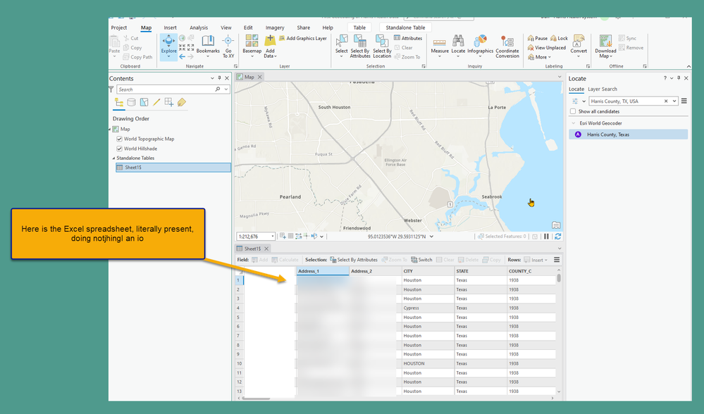

What is the point or goal of attaching data to a map in ArcGIS Pro? I have attached 240,000 addresses. Here they are; you can see them in the picture. So what? What good is supposed to be provided?
If I need to have longitude and latitude values created for these 240,000 addresses, has attaching the data like this made any kind of progress?"
One of the things I need done is to have latitude/longitude data added to each of the 240,000 addresses.  Does attaching the 240,000 address to the map with an excel file help with that goal?

For the purposes of showing the data on the map, you can geocode the data based on the Address_1, CITY and potentially State and Zipcode columns and see the addresses as points on the map by converting the table into a point feature class. Although, 240,000 addresses will cost you some credits if you use ESRI's geocoder.
This can be achieved using Geocode Addresses (Geocoding)
Tutorial: Geocode a table of addresses
A free alternative could either be to use your own locator/geocoder or use programming languages like R or Python.
How To Geocode In R For FREE
The above mentioned methods will add latitude/longitude data to each of the 240,000 addresses.

Hi Dan, so the geocode address tool in ArcGIS Pro automatically adds the lat and long columns also known as X and Y columns to the geocoded feature class. You can see this by opening its attribute table.
