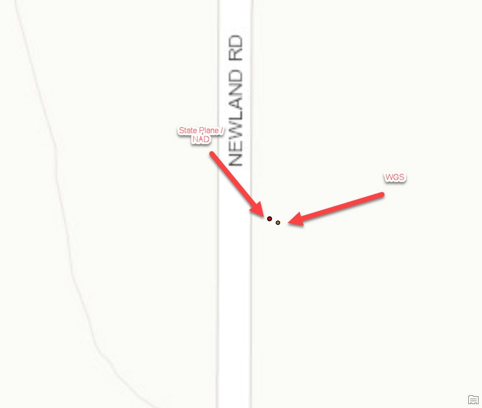

I have a issue where I have data generated in WGS 1984 and when we project the data into NAD 1984 the two points that should line up are now off by a few meters.

Which essentially says the datum have drifted apart. Is this a known issue, and I need to store data in these two projection but display them on the same map. Is there a process to fix this?

Hey Dan,
Thanks for pointing me in the correct direction. The issue is the projection tool was using NAD_1983_To_WGS_1984_1 and I needed to use WGS_1984_(ITRF00)_To_NAD_1983 for a state plane projection.

Hey DrVSSKiran,
Thanks for the reply. My map already has a defined projection and they don't line up. Usually you are correct the data should be projected on the fly and use the map projection, but that doesn't seem to be helping this time.
