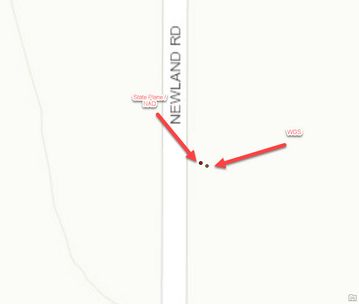

Hello,
I have a issue where I have data generated in WGS 1984 and when we project the data into NAD 1984 the two points that should line up are now off by a few meters.
I found this thread on this issue.
https://community.esri.com/t5/coordinate-reference-systems/issues-with-wgs-1984-itrf00-to-nad-1983-d...
Which essentially says the datum have drifted apart. Is this a known issue, and I need to store data in these two projection but display them on the same map. Is there a process to fix this?

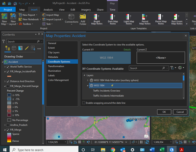

DrVSSKiran
Hi Jim,
When two different layers are in two different project systems and you want to open in a single map frame. There is the only one solution to define the coordinate system in Map frame.  Thanks
JimWilliams
Hey DrVSSKiran,
Thanks for the reply. My map already has a defined projection and they don't line up. Usually you are correct the data should be projected on the fly and use the map projection, but that doesn't seem to be helping this time.
DrVSSKiran
Hi Jim,
If your map is already defined a projection and still issue persists, then
we need to correct the data or else transfer both datasets into single
projection system.
Thanks
JimWilliams
Thnaks for the help,
That still doesn't explain two data sets from the same source, one in WGS other same data set in NAD would not be able to be projected on the fly and line up.
