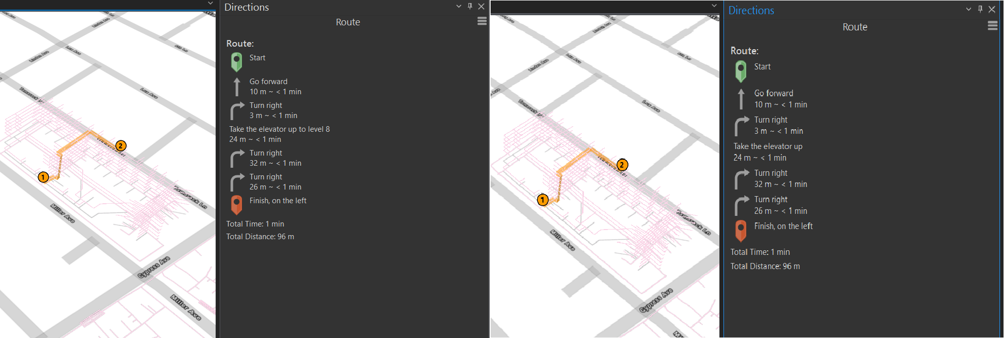

I am working on ESRI Indoors information model to get inddor navigation in a community apartment.
I noticed, the default configuration of the Indoors product files(available in My ESRI) shows the transition direction perfectly with 'Take the elevator up to level 2' where the level numbers show up.
But when I try to modify the following changes, the capability to show directions on transition changes to 'Take the elevator up' and the level numbers never show up again irrespective of any other changes in the network dataset property.
1. Add field in Pathways
2. Add field in Transitions
3. Confirmation/Turn tolerance changes in Landmarks
4. Any minute change in cost in pathways/transitions.
5. Enabling Hierarchy
6. Adding new sources in the network dataset ('Network' feature dataset). Basically any change in the Network Feature Dataset or Network Dataset property is dropping this capability.Indoor direction comparison.png
Although the directions are not impacted when 'Indoor' Feature Dataset is changed, this problem with the network dataset is restricting me to make any minute changes in the direction to customize them.
