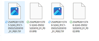

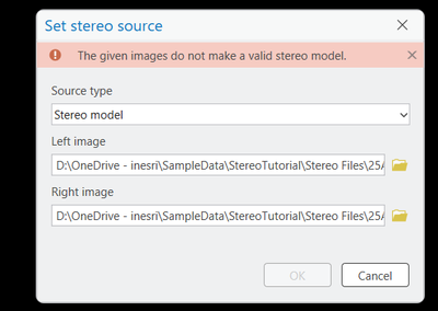

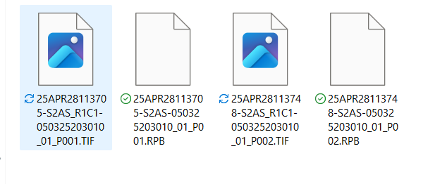

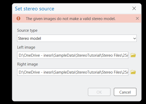

We are trying to set-up a stereo map in ArcGIS Pro however, when we add left & right image in Set Stereo Source dialog box it gives an error of "The given images do not make a valid stereo model". We suspect this is happening because the Pro is not able to read the associated .RPC file which is in .RPB format following this documentation : https://pro.arcgis.com/en/pro-app/latest/help/analysis/image-analyst/stereo-map.htm
Attached is the screenshot for the reference.

Was able to resolve the issue after renaming the .tiff file same as .RPB file
