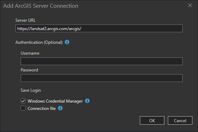

@AprilWheeler ,
Make sure you are using the following URL when adding the ArcGIS Server connection:

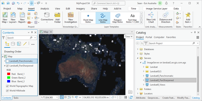

Hi April,
Check your catalog pane after connecting, the server should be there.

@AprilWheeler ,
