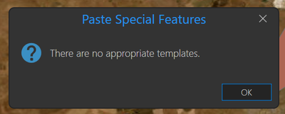

I am (and have been) experiencing the same issue. I am trying to make a duplicate of a polygon via copy & paste special, and this is the result:
This does not happen every time, but still regularly. Curiously, if I keep trying, at some point it will work - with no change in my workflow.

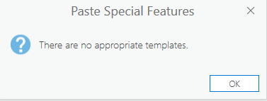

I am using ArcGIS Pro 3.2.2 and I am still experiencing this copy and paste issue.
I initially thought it had something to do with very large datasets, but it seems that this is not the case at all as I have just created two new polygon shapefiles on my c-drive. I added them to a new map view, digitized random shapes and then tried to copy and paste one polygon feature from one to the other. I select the polygon, click copy, then on the paste drop down I choose "Paste Special" and then I get the following error message: "There are no appropriate templates":
If I keep trying it eventually works. Most of the time I must try up to 10 or more times for it to work. This has to be a bug. This is supposed to be a simple straight forward task that no one should struggle with. It wastes an awful amount of time and is very frustrating. I really hope ESRI seriously investigates this issue.
