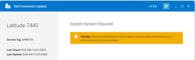

Second issue to beware of, if you have a DELL computer, they released several DirectX12 driver updates for their graphics cards. Run Dell Command Update Center to check for driver updates. We have several machines that had graphics display issues that were resolved once the November 14, 2025 graphic driver updates were installed.
TrentonWalker
Hi Richard,
Thanks for both of your suggestions. I checked my Dell Command Update center, and it's fully updated (and showed the November 14, 2025 update in its history). I found out I was running on DirectX 11 and switched to 12, but it didn't make a difference.
The few other GIS people in my office don't seem to have a problem getting those layers to display, so it's clearly something on my end, even though we all have identical settings... I'll keep searching and troubleshooting. Thanks again.
