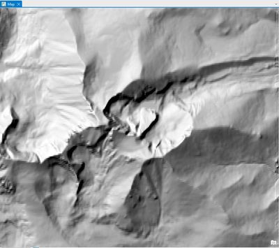

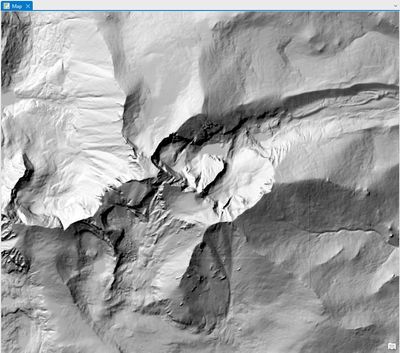

So I'm seeing the same thing with regards to spatial resolution of the Terrain:Hillshade layer as well.  At 1:30000 and higher scale values, it's pixelated/blurry.  And at 1:31000 and lower scale values, it's clear/crisp - see images below
1:300001:300001:310001:31000
The Live Feeds Status is showing everything as normal but clearly there's an issue - ArcGIS Online Health Dashboard.  I think reporting an issue on this page would be the next step.

Edit (again, sorry): I can't seem to get the higher resolution version no matter what my scale is set at. There's no difference between 1:30k and 1:31k, and it seems like it's the low-resolution version all the way up to 1:200k and presumably beyond, although at that scale it's not really noticeable.
