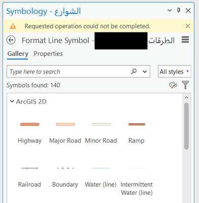

I've included a screenshot of the error. All is shown is the yellow error message. There's no code or anything else more descriptive.
I'm also getting it when going into the new "Clusters" tab in the symbology properties, but I'm not even trying to make changes here.

ElieRizk
Polyline Symbology  error: "Requested operation could not be completed"
The issue persists in AGP 3..3.1 it is a show stopper to work with complex symbology for polyline layers. we are not able to move forward with projects.
we tried the steps mentioned in the following ESRI technical support page without success.https://support.esri.com/en-us/knowledge-base/error-requested-operation-could-not-be-completed-00002...
